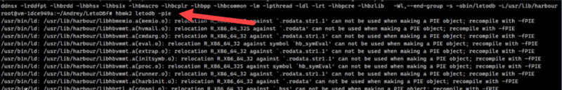

Собираю LetoDBf из последних исходников на Debian GNU/Linux 11 (bullseye) x86_64
Версия ядра 5.10.0-27-amd64
запуск - hbmk2 letodb
Выдаёт кучу ошибок:
root@vm-1dce949a:~/Andrey/LetoDBf# hbmk2 letodb
/usr/bin/ld: /usr/lib/harbour/libhbmemio.a(memio.o): relocation R_X86_64_32 against `.rodata.str1.1' can not be used when making a PIE object; recompile with -fPIE
/usr/bin/ld: /usr/lib/harbour/libhbvmmt.a(hvmall.o): relocation R_X86_64_32S against `.rodata' can not be used when making a PIE object; recompile with -fPIE
/usr/bin/ld: /usr/lib/harbour/libhbvmmt.a(cmdarg.o): relocation R_X86_64_32 against `.rodata.str1.1' can not be used when making a PIE object; recompile with -fPIE
/usr/bin/ld: /usr/lib/harbour/libhbvmmt.a(eval.o): relocation R_X86_64_32 against symbol `hb_symEval' can not be used when making a PIE object; recompile with -fPIE
/usr/bin/ld: /usr/lib/harbour/libhbvmmt.a(extrap.o): relocation R_X86_64_32 against `.rodata.str1.1' can not be used when making a PIE object; recompile with -fPIE
/usr/bin/ld: /usr/lib/harbour/libhbvmmt.a(initsymb.o): relocation R_X86_64_32 against `.rodata.str1.1' can not be used when making a PIE object; recompile with -fPIE
/usr/bin/ld: /usr/lib/harbour/libhbvmmt.a(proc.o): relocation R_X86_64_32S against symbol `hb_symEval' can not be used when making a PIE object; recompile with -fPIE
/usr/bin/ld: /usr/lib/harbour/libhbvmmt.a(runner.o): relocation R_X86_64_32 against `.rodata.str1.1' can not be used when making a PIE object; recompile with -fPIE
/usr/bin/ld: /usr/lib/harbour/libhbvmmt.a(harbinit.o): relocation R_X86_64_32 against `.rodata' can not be used when making a PIE object; recompile with -fPIE
/usr/bin/ld: /usr/lib/harbour/libhbrtl.a(cdpapi.o): relocation R_X86_64_32 against `.bss' can not be used when making a PIE object; recompile with -fPIE
/usr/bin/ld: /usr/lib/harbour/libhbrtl.a(chrasc.o): relocation R_X86_64_32S against symbol `hb_szAscii' can not be used when making a PIE object; recompile with -fPIE
/usr/bin/ld: /usr/lib/harbour/libhbrtl.a(console.o): relocation R_X86_64_32 against `.rodata.str1.1' can not be used when making a PIE object; recompile with -fPIE
/usr/bin/ld: /usr/lib/harbour/libhbrtl.a(datec.o): relocation R_X86_64_32 against `.rodata.str1.1' can not be used when making a PIE object; recompile with -fPIE
/usr/bin/ld: /usr/lib/harbour/libhbrtl.a(dates.o): relocation R_X86_64_32S against `.rodata' can not be used when making a PIE object; recompile with -fPIE
/usr/bin/ld: /usr/lib/harbour/libhbrtl.a(dateshb.o): relocation R_X86_64_32 against `.rodata.str1.1' can not be used when making a PIE object; recompile with -fPIE
/usr/bin/ld: /usr/lib/harbour/libhbrtl.a(errapi.o): relocation R_X86_64_32 against `.rodata.str1.1' can not be used when making a PIE object; recompile with -fPIE
/usr/bin/ld: /usr/lib/harbour/libhbrtl.a(file.o): relocation R_X86_64_32 against `.rodata.str1.1' can not be used when making a PIE object; recompile with -fPIE
/usr/bin/ld: /usr/lib/harbour/libhbrtl.a(filebuf.o): relocation R_X86_64_32S against `.rodata' can not be used when making a PIE object; recompile with -fPIE
/usr/bin/ld: /usr/lib/harbour/libhbrtl.a(filesys.o): relocation R_X86_64_32 against `.rodata.str1.1' can not be used when making a PIE object; recompile with -fPIE
collect2: error: ld returned 1 exit status
hbmk2[letodb]: Error: Running linker. 1
gcc '/tmp/hbmk_kZVs1X.dir/server.o' '/tmp/hbmk_kZVs1X.dir/errorsys.o' '/tmp/hbmk_kZVs1X.dir/common.o' '/tmp/hbmk_kZVs1X.dir/errint.o' '/tmp/hbmk_kZVs1X.dir/leto_lnx.o' '/tmp/hbmk_kZVs1X.dir/letoacc.o' '/tmp/hbmk_kZVs1X.dir/letovars.o' '/tmp/hbmk_kZVs1X.dir/letofunc.o' '/tmp/hbmk_kZVs1X.dir/letolist.o' '/tmp/hbmk_kZVs1X.dir/leto_2.o' '/tmp/hbmk_kZVs1X.dir/blowfish.o' '/tmp/hbmk_kZVs1X.dir/common_c.o' '/tmp/hbmk_kZVs1X.dir/lz4.o' '/tmp/hbmk_kZVs1X.dir/lz4net.o' '/tmp/hbmk_kZVs1X.dir/PMurHash.o' '/tmp/hbmk_kZVs1X.dir/hbmk_zyaxX0.o' -Wl,--start-group -lhbmemio -lhbct -lhbextern -lhbdebug -lhbvmmt -lhbrtl -lhblang -lhbcpage -lhbrdd -lhbuddall -lhbusrrdd -lrddntx -lrddcdx -lrddnsx -lrddfpt -lhbrdd -lhbhsx -lhbsix -lhbmacro -lhbcplr -lhbpp -lhbcommon -lm -lpthread -ldl -lrt -lhbpcre -lhbzlib -Wl,--end-group -s -obin/letodb -L/usr/lib/harbour
Как собрать Лето под Debian ?

ссылка на сообщение  Отправлено: 31.08.24 20:06. Заголовок: Тут вот компилятор с..
Тут вот компилятор сам предлагает:

ссылка на сообщение  Отправлено: 31.08.24 22:00. Заголовок: PSP пишет: recompil..
PSP пишет:
И куда это вставлять ?
Я очень давно, лет 7 назад собирал под Linux, но тогда сразу собрался.
А сейчас труба...

ссылка на сообщение  Отправлено: 01.09.24 19:02. Заголовок: Andrey пишет: И куд..
Andrey пишет:
в HBP файлик думается

ссылка на сообщение  Отправлено: 02.09.24 13:37. Заголовок: это опция gcc добавь..
это опция gcc
добавь в HBP строку -pie
Пост N: 7843
Зарегистрирован: 12.09.06
ссылка на сообщение  Отправлено: 02.09.24 14:37. Заголовок: Не помогает... https..
Не помогает...

ссылка на сообщение  Отправлено: 02.09.24 16:05. Заголовок: Andrey в протоколе ...
Andrey в протоколе ... recompile with -fPIE, если это к параметрам запуска, то надо так и задавать, причем
hbmk2 [options] [<script[ s ]>] <src[ s ][.prg|.c|.obj|.o|.rc|.res|.def|.po|.pot|.hbl|@.clp|.d|.ch]>
Options:
-F<framework> link with <framework> framework (Darwin only)
т.е. -help надо смотреть
Дима, говорит про вставку в файл сборки <имя>.hbp
пробуй

ссылка на сообщение  Отправлено: 02.09.24 22:51. Заголовок: Не помогает, не соби..
Не помогает, не собирается...
Там - https://github.com/elchs/LetoDBf/tree/master
Тоже был вопрос про сборку, год назад, но ответа нет.

ссылка на сообщение  Отправлено: 05.09.24 09:11. Заголовок: Поставил флаг в leto..
Поставил флаг в letodb.hbp
-cflag=-fPIE
Такая же ошибка.
И как собрать ?

ссылка на сообщение  Отправлено: 05.09.24 15:25. Заголовок: Dima пишет: а так ?..
Dima пишет:
а так ? )
-cflag=-fno-pie
Правильнее будет:
-ldflag=-no-pie
потому что это флаг линкера
Пост N: 7847
ссылка на сообщение  Отправлено: 08.09.24 00:02. Заголовок: Спасибо БОЛЬШОЕ ! :..
Спасибо БОЛЬШОЕ !
С этим ключом компиляция прошла нормально !
